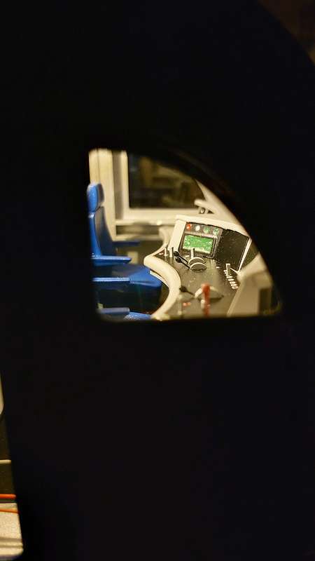

After 13 months of work, sometimes slow, sometimes more intense, I finished project of a model of modern locomotive E6ACT-008 Dragon in Lotos Kolej livery. Locomotive was designed by Newag Poland and now is produced in version Dragon 2. Model is made in scale 1:32. Below you can see some pictures.
If you are not bored yet you can take a look at some short films with test rides.

The design process was about 1 year with detailing and manufacture took me about 13 month but not constant every day work.Steffel hat geschrieben:Hello Jacek,
great praise, that's a fantastic job.
I have never seen anything like this, especially this fine detail.
The reports also seem to me to reflect the construction time, which is extremely fast.
Absolutely perfect.
All model is made of brass which was laser cut according to my project. Some elements are 3D printed, some are brass casted and very precise parts are photo etched. All elements are soldered, very few are glued.
I also make my own driving system based on cardan shafts which I make also myself.
I had complete documentation of the locomotive provided by manufacturer in 2014.Steffel hat geschrieben:The CAD design in 3D seems very complex to me. Which program do you use?
Do you have original blueprints? Or do you use photos?
I use Inventor for the design.

Parts that can be made on lathe yes, rest is made externally. I have only simple tools and a small lathe.Steffel hat geschrieben:Hello Jacek,
Inventor is a very nice tool for such work.
Do you also manufacture parts at home on your own machines? Or do you have all parts manufactured externally?
Yes, it is. Previous models I made were 100% hand made.Steffel hat geschrieben:I think that's the right way. Development and design on the computer and outsource many parts of the production. it gets more precise and you can move forward much faster.
Yes, and my answer is no. It is not fun then when you do it for somebody else not for yourself. I did some time ago 15 advertisement models of locomotives in 1:32 and it was not fun.Steffel hat geschrieben:Have you ever thought about starting a company that builds the models in series?
